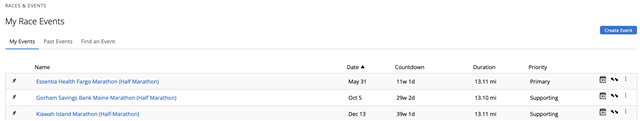

My goal races are still correct in Garmin Connect but my watch recently reset to my October half marathon. I use Daily Suggested Workouts so how can I ensure those are based on my May half marathon? The watch is only showing my 2 fall half marathons now instead of all 3 upcoming races.
  • Which race is set as the primary event? It is usually based on that. If you look on the app ?   More > Training and Planning > Races and Events> you can see and reset it there
  • Yep, I've made no changes, just the watch (since an update I think) is now not showing Fargo and the DSW's are based on Maine.

    Or try first to change primary on Garmin connect app to one of the other races and back.

  • Thank you both! I did a version of this and the watch is back on track Slight smile
