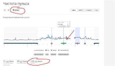

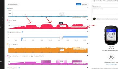

The 2nd point is again related to this, I turn on 540, I train, my pulse during training, for example, is 140 average, the watch is on my hand, the pulse on the display is 80 (I already found out that when training is not going on, the pulse sensor works in economy mode and it does not display the pulse very accurately) oh well, after I trained and synchronized 540 with GC, it is logical that my pulse during training on the pulse graph should be updated to what it was during training, but no) I do not see this, this is also very logical, why is this not implemented?

  • Regarding calories, I always train with a chest sensor, I have a smart Elite machine, there is a power meter, through the power you can already find the calories burned. But the most paradoxical thing is that on the 3rd day my active calories from training were counted in Garmin Connect, yesterday I saw 1800 + 1200 (for training), I don’t know why it wasn’t like that before.
    Regarding the pulse, I repeat, I always wear a 540 chest sensor + a chest pulse sensor. At the time of training, there are 255 on my hand without training, they are simply actually on my hand, but they take the pulse incorrectly when training is not running in them, the pulse is 70-100, although during training I can accelerate the pulse to 170, which is shown by the chest sensor.
    And the whole problem is that after finishing the workout, the pulse graph is taken from the watch, it is not updated from 540 for this period of time and it turns out that according to the watch my pulse is 80 average for 2 hours of training, and according to 540, 140 pulse.
