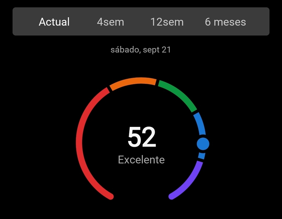

I had a Vivoactive 4 that upgraded recently to a FR 255 Music. Everything is working great except for the Vo2 Max calculation. I have been using the watch during 2 weeks, had a few runs that according to the manual must calculate or update the Vo2 Max value. But the last value in the chart is from 4 weeks ago, when i was still using the Vivoactive 4.
The main problem with this is that others functions of the watch depends on this value. Like training status, LTHR calculations, race predictors, DSW, etc.
The runs are outdoor with GPS in a flat surface, HR is 70% or higher for more than 10 min continuous, HR is recorded using a Polar H9 Chest Strap BT, the weight value is updated. The device is also configured as the main training and wearable device. I removed the VA 4 from my Garmin account.
I don't know if there is something wrong with the watch. According to my max HR of 201 bpm, the 70% is about 141 bpm.
Current Vo2 Max at 18/10/2024, from almost 1 month ago

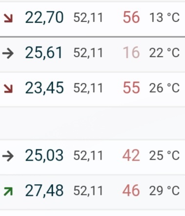

And these are some of the runs that i made during this week
