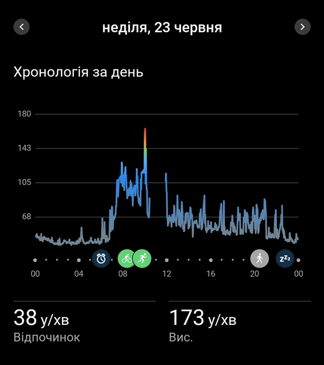

  • Same problem here, but inbetween of a longer bike trip.
