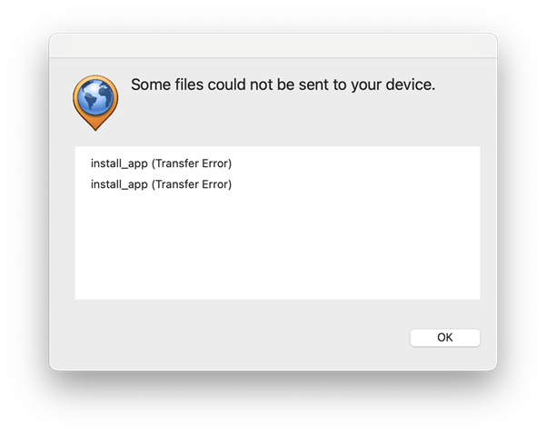

I've tried using Garmin Express (7.20, from an M1 Mac), but I get a transfer error. (See attached screenshot.)
I've also tried installing updates individually, but they all get the same error.
Thank you for sharing the screenshot.
Can you please follow steps 1-21 from Full Uninstall of Garmin Express/Garmin Express Fails to Uninstall, re-download Garmin Express, re-add your device and search for updates again?
Let me know if that works!
