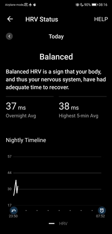

  • After 18.22 was installed yesterday, I synced a few hours later, then restarted the watch. At bed time I tried to do a Health Snapshot as per usual. It vibrated four or five times before I got one start of Health Snapshot that didn't vibrate. Unfortunately one of the times I stopped the HS, it triggered morning report, minutes after I'd put my head on my pillow, so HRV reading was cut off. I manually started sleep mode, but it wasn't enough to get HRV to record for the whole night.
    I was able to live with it before, but this is no good!
  • It happened again. The morning report got triggered when I went out of the Health Snapshot because of the buzzing. I will leave it on, hoping the HRV status doesn't get cut off.
    But this is impossible! I need to see recovery time after Health Snapshot, and now I can't!
  • I lost only one hour of HRV data this last night, but I had no access to any screens until the morning report timed out. I don't know when that happened.
  • Exact same thing happened to me, on 18.22. Initiated a health snapshot at night, with watch already in Sleep Mode (triggered automatically). Got the continuous buzzing, stopped the snapshot, did another snapshot, and a morning report was launched as if I had awakened in the morning lol.

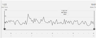

    This is what a normal night looks like:
