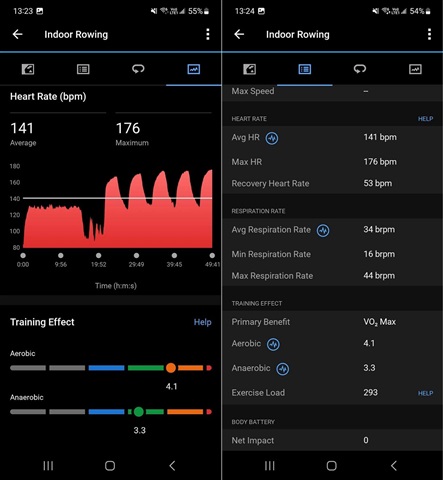

Can someone give me an example of an exercise that would have me "exercise at VO2Max" ? If it matters, Garmin estimates my VO2Max to be 44, which is identical to the estimate following my last treadmill test at the cardiologist (Bruce Protocole)  a few months ago. If it matters also, I estimate my true MaxHR to be 175.

    Heart rate takes minutes to reach VO2max bpm, so aim for speed unless your VO2max intervals are long enough to reach VO2max bpm (which would make it a very hard workout!).
