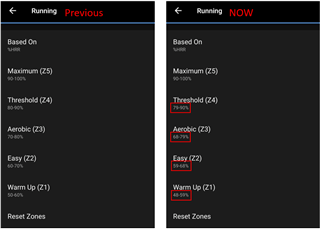

I found that my ‘Sport HR zone’ changed which I don’t know when and why did it change.
However, I also checked ‘Normal HR zone’ but it didn’t change.
I set the %zone the same between normal and sport HR, the difference is how it calculates(max HR and HRR).
%Zone setup
Z5: 90-100
Z4: 80-90
Z3: 70-80
Z2: 60-70
Z1: 50-60
I know that the bpm will change according to the max HR and RHR but what I’m confusing is the % that I set was changed.
The change of my ‘Sport HR zone’, please see in the picture.
Question:
  1. Is this normal that %HR zone automatically changed?
  2. What is the factor of this change?
FYI: My Max HR has been increased few weeks ago. I suspect this as the cause. Tbh Only thing that change should be the bpm which based on the calculation but not the %zone, right?
