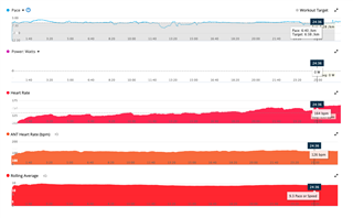

14.20 Bug - Continuously increasing Heart Rate During Easy Run & 0W Running Power to boot!
I had running power enabled and wrist based power
Using a running pod which I do most of the time.
I tested side-by-side with my very reliable Polar OH1 which has never had any issues at all.  Temperature was 7 degrees C outside so maybe it can't cope with slightly cold weather?

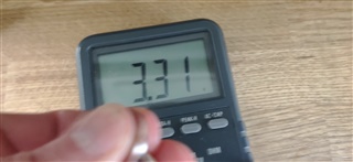

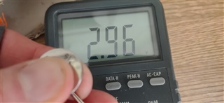

  • Look like I found the issue with the zero Watts - the battery was well below 3V - so although the running pod was connected it didn't have enough battery to send out data - for the speed it must have defaulted to GPS but the software doesn't do the same for Watts it seems :
    old battery
    new battery
