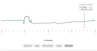

  • Interesting that the watch did, and is continuing to, record HR data when I'm not wearing it. Must be a ghost. I did a re-boot to see if that stops the continuous HR recording. Below shows some erroneous sleep HR data, followed by running activity HR data (when watch was worn), followed by rest of day HR data when watch just sat on table.
