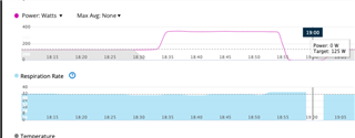

  • seemed to start after I just changed screens to check stats, then carried on after that
  • loss of resistance control, only recovered ( setting the correct target for the rep) after hitting lap button, it got stuck on previous target even though the next easier rep had started

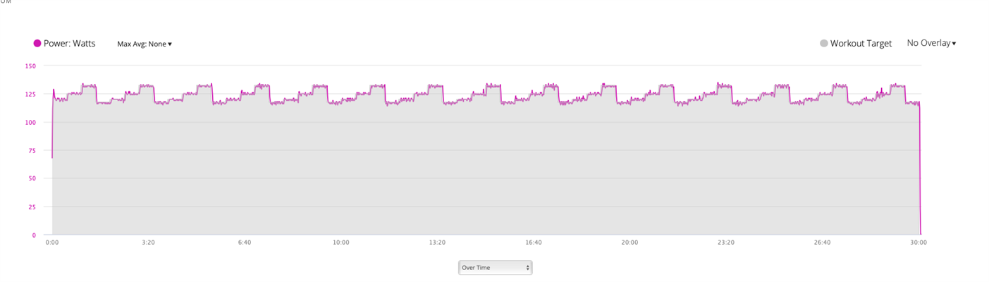

for comparison, a similar workout without any issues - the main bit is in ERG mode so when it's working there is virtually no variation in Watts :
yesterday's Garmin-suggested recovery workout @ 123W : no issues at all

the issue didn't correct itself so when I hit the lap button the watts for the next rep were fine - see image

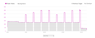

Fri 3rd March : no issues
Workout notes: 15 x ( 4 x 30s blocks of custom power targets to stress-test ERG mode ) - 60 reps in total, 30mins
Phone status : Airplane mode enabled | BLE off | Wifi off
Router status : 2.4GHz off | 5GHz on
Zwift Hub : Spin-down calibration done
Zwift Support recommended a spin down per use yesterday

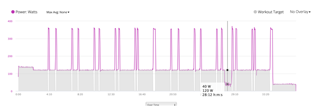

Sunday 5th March Update
All the same conditions as above, except:
Workout notes : Power Curve Targets
New insight : respiration rate drops out at the exact same time!
respiration is never an issue where there aren't 0W issues:
There seems to be some coincidence where the drop-outs are in relation to the main intervals:
Note there is an existing bug where the target shows up as 0W, so maybe the software on the watch is setting it wrongly to 0W??

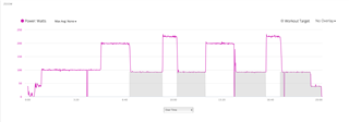

 Power drop-out whilst going for a run.
No external sensors attached and I didn't stop running as can be seen  from the pace :
