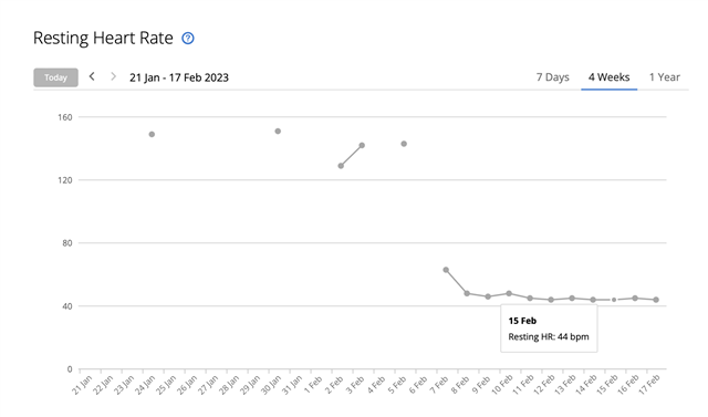

I hadn't been using my Forerunner 255 as my primary watch and as I use the HRM pro when running, I'd disabled the wrist HR. Annoyingly, Garmin connect shows my resting HR as the lowest HR recorded during these runs which clearly isn't my resting HR. Instead of a resting HR of 44 it shows figures around the 140-150 mark which actually seems closer to what my average HR on a run would be. It didn't do this on the 245 or the Fenix 6 before that and now that I'm using it as my main watch it's throwing off the other metrics that are based on resting HR, such as fitness age.
If you look at the chart below, I started wearing my Forerunner 255 everyday from the 7th Feb so all the joined dots shows my normal resting HR since then. The other dots sitting between 120-160 bpm are the days when I ran. What's even more annoying is that I can't delete this errant data so I'm stuck with it.
Anyone else having this issue with the 255?
