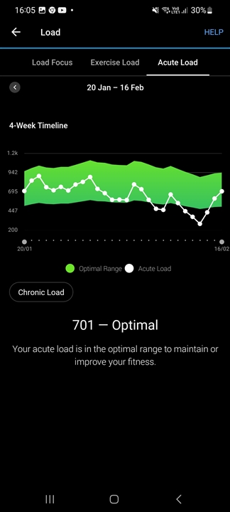

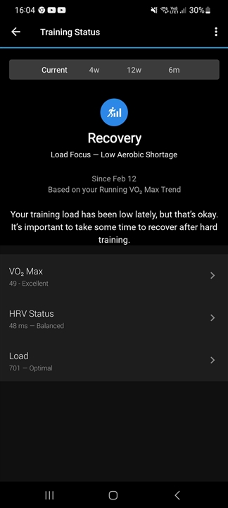

Hi after update 14.15 for my FR255. I notice my acute load optimum and vo2max trend increased. But my training status still show recovery. It suppose to be productive am i right?
After i reset and default and watch and garmin connect still the same.
  • Mine has been under Maintaining since I got it January 2. Even though my Load is Optimal. If you click on Load on the left screen shot, It shows where your are short or high in the calculations
  • You have been on the lower end and below the optimal load range recently for quite some time.
    Just because you’re back in the range since two days, does not mean, you are building your form (from the perspective of the algorithms).
    Give it some time and look after, what part of the training is short, like sgreestonenj wrote. As far as we can see, you need more low aerobic aka base training.
    Also, the training status is not always reflecting everything. I am also in „Maintaining“ most of the time, still my VO2Max has increased by one point and the race predictions are much better than some weeks ago.
    In the end, it’s just a trend indicator.
