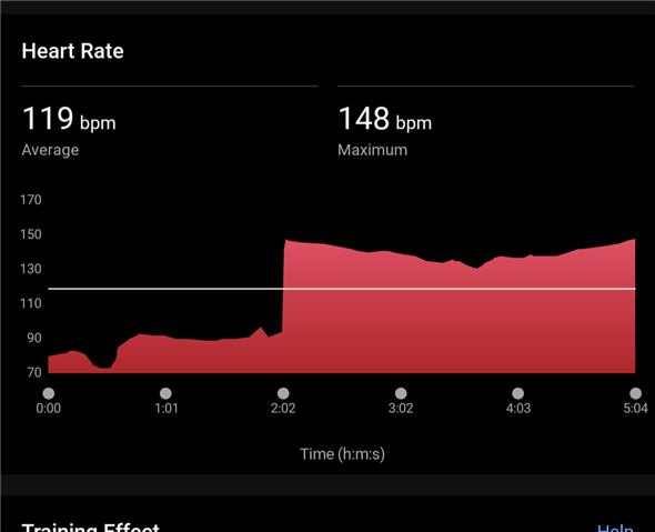

    This morning, everything was working fine until 30min. Past that, the HR suddenly dropped below 100bpm which is impossible as I was doing 6' runs at 4:36/km. At the end of the run, when running slow, seems like it was back to normal.
    Any way to fix this?
  • Same here today. HR missing for a while, then showed again but droped to much lower values than my real HR. I'd HR between 160 .. 180 during this session, definitely not below 100.
    Forerunner 255 (not S/music), FW 17.26.
  • Also experiencing issues on Forerunner 255S Music FW 17.26. HR seems to just drop or increase randomly by a fixed amount. For example my HR could be stable around 150 then suddenly becoming stable around 170. Then later coming back to being stable around 150. In that example it seems to be just an offset of 20 added to the HR for no reason. Is it possible to get an update on this or should i return my watch ?
