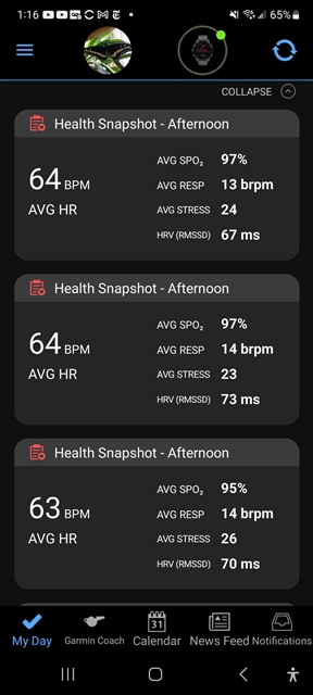

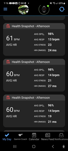

Below are two health snapshots that I took 30 minutes after waking up and before any coffee.  The top measure was done with the HRM-Pro+ heartstrap on and the bottom measure was done using the optical sensor on the Forerunner 255.  You can see the numbers are wildly different.
Health Snapshot Strap vs Optical
I've repeated this experiment several times and at different times of the day.  This disparity would be OK if the difference between the two values were predictable.  The problem is that no matter what happens when I run the health snapshot the value coming from the optical sensor is in the 20s but the heart strap (depending on time of day, etc) has been anywhere from 50 to 99ms.

Just to be sure, I did a set of 3 tests in a row (6 tests in total) where I used only the optical sensor and then the HRM-Pro strap.  You can see the results are some 50ms off!  How is this possible?
