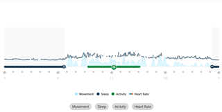

The issues that I've been having are connected to missing heart rate data. During sleep, I often get blank spots of heart rate, also, during the day when I move around the house doing some random things the heart rate just isn't recording.
Here is an example of a heart rate chart with sleeping and movement:

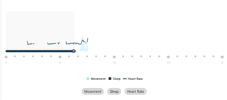

But the missing heart rate which causes most issues is the one during sleep:
-> this is from today, I've slept quite well from 23:30 to 7:30, but my Garmin recorded it only from 2 AM to 7 AM, this of course messes up the suggested workout for running (recommends recovery)...
