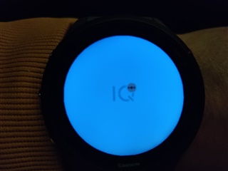

CIQ datafields are not visible at second start
GF255 FW 13.21
Workaround: Back once more to get to watch screen, then App again

  • Watch is reset manually (in addition to the spontaneous resets) many times since the upgrade to 13.21 a month ago. Will try when connected to express too ( I do not have much hope).
    Removing and adding again works too, but it is easier to go back one step more thank to readd. The issue occurs also for newly added fields.
