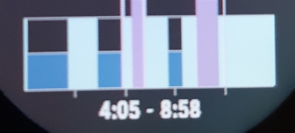

During the passage between summer time and daylight saving time the watch monitored my sleep.

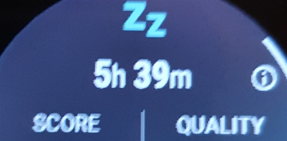

When I woke up the time of my awakening was correct, but the time of me falling asleep was still displayed using the old time reference. The asleep time was correctly calculated though. On garmin connect even the time of me falling asleep was correctly shifted.
So to be clearer the time went one hour back (eg from 3 am to 2 am) and the time of me falling asleep was 3.05 (which would have been 4.05 with the old reference) and was not shifted to 3.05 on the watch, but kept to 4.05. The awakening time was 8.58 (9.58 with old reference) and was correctly displayed on the watch. The sleep time was 5.39 and it is strangely correct. Garmin Connect displays 3.05, 8.58, 5.39, so all the data is correct there.
Just wanted to report this bug to the Garmin team, being this an hard to reproduce bug.

  • But if Connect shows one time for the start of the sleep and the watch shows a different one, but they show the same time for the end of the sleep, one of the two has to be wrong XD.
    And the time reference change happened before the start of the sleep, so both the start and end times should be shown using the new reference time, so the right one is Garmin Connect, and the watch is showing wrong data.

  • The watch did use the garmin connect app to get the time (see https://support.garmin.com/en-US/?faq=z9ue29cdcD8SHu28Lo8VY5). In order to use the gps the watch has to connect to the satellites and it does this only if you either manually do it through the settings or if you start an activity, but not by itself, and I for sure did not do any of the two while I was sleeping (plus I was inside a building, so the watch could not connect to the satellites).
    Anyways how the time is acquired is not important in this situation because the watch, as you can see in the photos, calculated the sleep time in the correct way. That means the problem is not in the time acquiring process, because that one succeded perfectly. It knows that I slept from 3:05 to 8:58, it is just wrong in displaying the sleep start time.
    I think the problem is in how the watch manages the data in this situation through software. So it is not that difficult to fix this issue that has caused more than one problem, as you can find another post from today in this forum discussing a similar situation.
