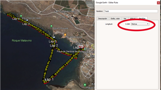

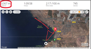

Hi all. I have bought new garmin forerunner 255 and open water activity recording is pretty disapointing. I previously owned fenix 3 and forerunner 735xt and my pace during open water activity is between 1:50 and 2:10 per 100m. With 255 is around 2:45 and 3:20. I also swam with both fenix 3 and 255 on my wrist and 255 was pretty off. I used all possible satelite configurations the watch has but the erroneous readings persist. I also updated to the last software version through garmin connect (11.12) and nothing has changed. I'm pretty frustrated because I cant find whats wrong. I should add that I also used the watch for a 15k run along with my fenix 3 and the activity was recorded perfectly and a lot better than my fenix. Is anybody facing same problems?
