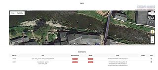

One of my local runs is through a narrow streets over very narrow footbridges - there is no difference worth speaking about between the Fenix 7, Forerunner 255 and even the Fenix 6 Pro
This is zoomed in 100% and is over an extremely narrow footbridge, less than 1.5 meters / 6 feet wide
The F7 and the 255 nail it perfectly - the F6 is probably about 18 inches offset from  the actual track. Even with the F6 Pro you have to be at 100% to see the track isn't perfect.
Here is another bridge crossing;
Again the 255 and Fenix 7 absolutely nail the bridge crossing - the F6 Pro track when zoomed in exhibits a typical 'tell' if you know what you are looking for - it's offset to the left from the actual track.
The new GPS chipset is very good, tracks are prettier, instant pace is better and time to get a lock is quicker - but it is not a huge improvement, it's a minor improvement IMHO.
