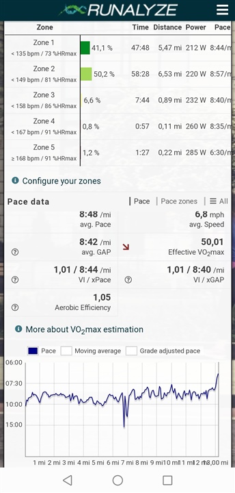

  • I think the whole race prediction/power/FTP calculation is faulty at the moment.
    I ran a 10K yesterday and was really struggling towards the end. However race prediction still tells me I will finish 5K and 10K around five to ten minutes faster each.
    In addition, even at "close to HR Max" speed, the power graphs show that I am just in zone 2 of 5, not even in the "pace" zone. Somehow the watch seems to think that what feels like a 9 out of 10 effort for me is just 30 or 40 percent of what I'm actually capable of.
  • In addition, even at "close to HR Max" speed, the power graphs show that I am just in zone 2 of 5, not even in the "pace" zone. Somehow

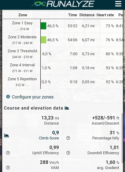

    This may be an obvious question but do you know your Running FTP?
    I use Runalyze and HR / power correlates very well.
    This is from an easy 13mile (21km) run earlier today
    HR
    Power
