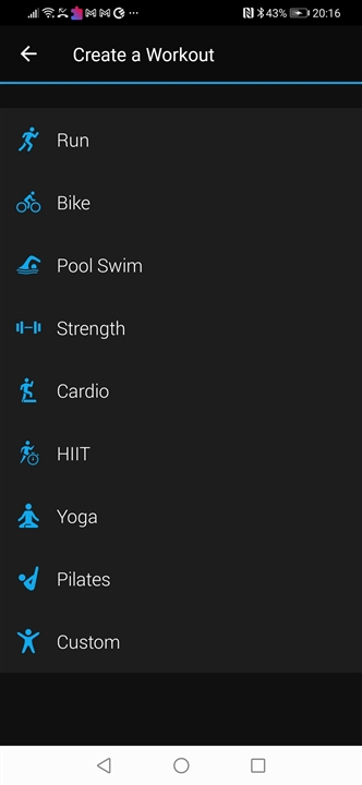

    I do not know much about rowing - which of the below is most appropriate?
  • custom, just put some repeats there, then sent to device, and you will find it under the indoor rowing app in the workout list! thank you

    I think the problem is having to create a Custom workout for rowing, whereas biking and running have specific workouts so the targets are announced.

    I have been messing more with this...
    if I create a Rowing workout as Bike and execute as Indoor bike voice workout step alerts work...
    but if the same workout is created as a Custom workout and executed as Rowing, no step alerts - and this happens on my Fenix 6 Pro too.
