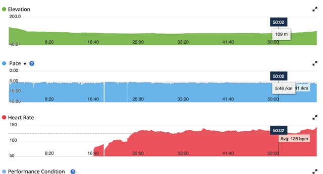

  • Hello All,
    I have the same problem with FR965: when you start the workout (e.g. a running session), than you have a chance that you get proper heart rate reading, but 8 out of 10 heart rate reading does not start at all! It shows you 80-100bpm, but it is clearly wrong. You need to stop, wait for a resting heart rate to be caught by the sensor, then it starts normally.
    here is an example what happens during workout:
    As you can see during the first 3rd of the run, there was no real heart rate reading, but the watch show cc. 90bpm. First when it happened, I was happy, that my VO2max increased from 52 to 74 instantly. I thought it's the new supplement ;) but, no, it was Garmin.
    I still have 27.09 FW version.
