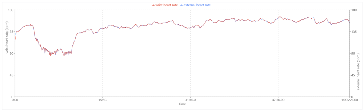

    You may just be unlucky to have a defective device. Personally, I get very accurate data from both sensors - as well from the wrist sensor as from HRM 600. I compare both sources frequently, and they are almost always closely identical, practically undistinguishable. And I compare the data also with other HRMs, so am pretty sure, the data is accurate. Have a look below for an example from today's run. The red (wrist HR) and blue (HRM 600) curves are practically identical, an overlapping exactly ~99.9% of the time. You have to zoom to the max to see some really tiny differences, which are unavoidable due to the delay between the electrical and optical signals. So for me, both the watch standalone, as well as the strap are perfect, and I cannot confirm your conclusion.

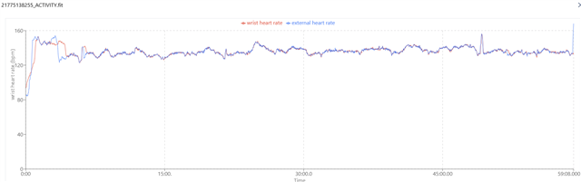

  • Sorry! Another try: 21775138255_ACTIVITY.fit
    Yes, it looks better. Below, there is the comparison of the HR from the wrist sensor, and from the external HRM.
    As you can see, the values from both sensors are pretty much identical, except of the periods corresponding to the Respiration Rate dropouts, but even then the difference is not dramatic. However, although I am pretty sure the HR from the strap was more accurate, the watch (using the HR Data Source Switching) gave the priority to the internal wrist sensor, and that's why it stopped recording also the Respiration Rate.
    You can avoid that the watch resorts to the less accurate wrist HR, by disabling the source switching in Wrist HR settings, in Sensors & Accessories. That should take care of the respiration rate dropouts. On the other hand, it won't really help with the issue from the OP. The peaks of high HR are present with both sensors, so I'd tell it is practically certain that your heart rate was really increased.
