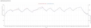

Export the activity file in the default FIT file format, load it to FIT File Viewer, click Chart at the top, select "wrist heart rate" for Y1 and "external heart rate" for Y2

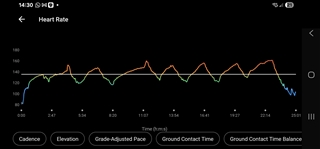

This is the superimposed WHR and HRM. Next is the HR graph from the activity Stats. it is clearly the WHR.
In the Activity Stats is shown the WHR. And this is what is considered for Activity evaluation.
Sounds indeed strange.

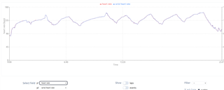

You can also select "wrist heart rate" and "heart rate" (instead of "external heart rate") in fitfileviewer. The option "heart rate" is what Garmin Connect then shows, so you can see whether it is 100% identical to the wrist HR, or whether there is some influence of the external HRM, anyway.
"Wrist heart rate" and "heart rate"are identical. External HR is clearly different.
Well, it looks like there are some tiny differences. Try zooming in, using the Filter function. The watch may be combining both sources, and for some (strange) reason, it trusts its own sensor more than the external one, but it is not 100% identical, hence it is clear both sources were somehow used.
Anyway, I recommend contacting the Support, sending them the screenshots, and asking for explanation why the watch prioritizes the wrist HR over clearly more credible external HRM strap.
