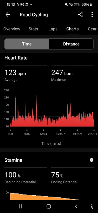

Hi,
Just bought new heart rate monitor HRM 200 and noticed unreal HR spikes. Max HR 247 ...
190 for short period of time without any reason and then back to 130.
Anyone else having similar issues?

I had sort of the opposite problem: not spikes up but down. When biking with an Edge 1040 Solar it sometimes would record 95 BPM for a second or two, then going back up to my actual heart rate (say 130 to 150). This made the graphs look like this.
My suspicion was that this is a Bluetooth issue, because it did not happen when running with a Fenix 6. There the connection is the "old" ANT+ method, whereas on the Edge 1040 solar I used the new encrypted connection/pairing method at first. Switching to the old unencrypted method seems to have helped on the Edge too, but I need more testing.
In the meantime Garmin email support also offered already to replace my unit, which I might do eventually within the guarantee period... But I just saw a post here that there is a new firmware update too which I do not have yet, so I will try that some day.
What firmware are you on, zgrega? And are you using the old or new/encrypted connection method / with what watch or other device?
