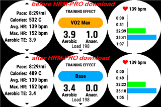

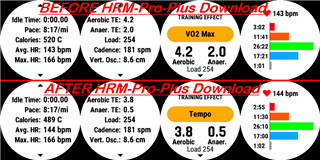

1. go for a run, I suspect ride would work too as long as you use a few zones
2. screenshot your load and zones like below
3. download the HR from the activity menu
4. screenshot that newly calculated load and zones
The zones from BEFORE the download add up to the activity time
The zones from AFTER the download are SHORT by around a minute (sometimes more)

    There's a minute of data missing, or more.

  • another egregious example where supposed VO2MAX level effort is converted to BASE effort after HRM-Pro-Plus download
    the effort actually was BASE as demonstrated in the HR graph, which really makes me wonder if it's the BEFORE that is done wrong on the Fenix6 (26.97b)
