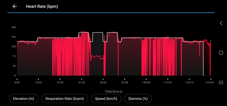

I have been using both these devices for quite some time now, without any issue. But since a bike ride on May 7th, I have now been having terrible connectivity between the two, when biking only (I go running and swimming often and rarely get any drop), on 2 occasions.
During the biking session, it manifests as the heart rate field value freezing for a couple seconds, then showing "--" for 5 to 10 seconds, then showing "71" and slowly climbing back up to my actual heart rate (sometimes it doesn't even get there before freezing again) for another 5 to 10 seconds, then freezing again, and repeating that cursed loop ad-nauseam.
Here's how it looks on garmin connect:
So I can't really follow a strict heart zone anymore because I can only see my actual heart rate very occasionally. It also completely falsify my intensities for the workout.
I am posting about this very specific behavior here because I couldn't find anyone else talking about it. Any idea what could this be?
