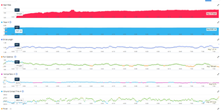

    Here are some stats from a run I did yesterday. Note vertical ratio and vertical oscillation are on the same graph. You have to chose one. The same goes for ground contact time and ground contact balance(L/R).
