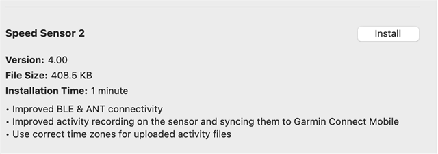

  • Just checked one of my sensors and it's still on 2.30. I did have .gcd files in my REMOTESW. Not sure what they were for (probably other sensors) but I've deleted them anyway,
    Connected to GE and now adding this to the F7 before trying to update the SS2
    and this in the REMOTESW folder afterwards:
    Went to Sensors and Accessories and connected to a SS2. Found a Software Update option so elected to install. Now updated the sensor. Not sure if this should happen automatically but the manual process has worked on one of them.
