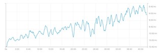

It's Garmin's footpod. I've had it for about 10 weeks. It calibrated itself (to 99.3) after a few runs, with Autocalibrate on. It seemed pretty good during treadmill runs, by which I simply mean it returned pretty darn consistent pace data, giving smooth pace lines during treadmill workouts, and the distance/pace data it reported seemed to match with my own perceptions of my pace and speed changes etc. It was mostly useful because it was really consistent. One example during a short treadmill run (on a wobbly cruise ship in pretty choppy seas nonetheless haha):
In the last couple weeks it's been dreadful, erratic and inconsistent. The pace fluctuates wildly over short periods - a few seconds or tens of seconds - and is so far off of the distances my treadmill measures (like >10%) that it is basically now untrustworthy. The speeds it reports varies by as much as ±1 mph, or pace ±1:30 min/mile even at totally constant treadmill belt speeds. Here's a representative tracing from a short, slower run from tonight; I increased the belt speed by 0.1 mph at the halfway mark, then a couple of times in the final quarter. But for the first half of the run, and then from the halfway mark to about 90% the treadmill belt speed was at a constant. But the pace graph looks like seismograph:
I do use it on a couple different shoes, which I know can affect calibration, but could that cause this much spiky data? I am careful to make sure the Pod is clipped on tonight and doesn't slide around. The battery is < 2 months old but I changed it after tonight anyway, and have re-paired it with my watch (fenix 6XS) even though I know it might reset my calibration.

  • Could it be the movement of rotating my wrist to look at the watch that does it, by changing the distance between the antennas?
    No, unless you inadvertently change your pace when being distracted by looking at the watch.
  • hey, thanks, yeah, thought of that too; maybe a momentary slight variation but not enough to account for the huge variations I'm seeing. I might just see if I can swap it with a new one.

    Have you tried changing the battery? When my HRM battery gets low, I get super weird and erratic results. Especially if it was working fine for the first 10 weeks and no major firmware update.
  • Thanks for your reply! I did indeed, and also have taken to power cycling the watch before starting a run, and it has been much better!
