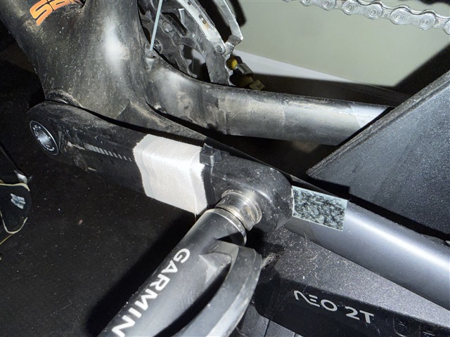

  • I followed a suggestion from another thread I found…add a thin piece of steel to the crank to extend it ever so slightly and the issue went away.  I was honestly blown away that this fix worked.  I just used a thin piece of steel from the electrical section at Home Depot.  No more rpm jumps…will hold me over till they fix this issue
  • So it sounds like they've just borked the sensitivity of the cadence sensor. Though I will admit even on 0.0.3x I still get wacky cadence jumping. I assume the Neo 3 has a better sensor placement?
