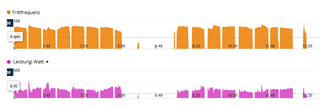

Since updating my Tacx Neo 2T to firmware version 2.6.0, I’ve been experiencing serious issues:
- Power output is delayed by 5+ seconds - Cadence is inaccurate and inconsistent

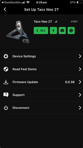

    1. I downloaded the Tacx training app to my Iphone. (Downloaded the latest version from apple store. 4.70.2)
    2. I ensured only the Neo 2T that I was downgrading was powered on.  (Eg the other was off)

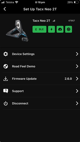

    3. I logged into TTA and connected the trainer.  This advised my trainer was at v 2.6.0.

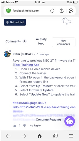

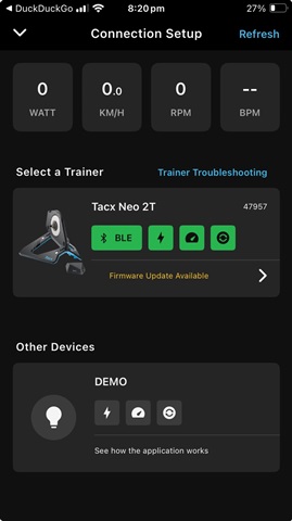

    4. With the TTA still open on the iphone (I switched to a browser and clicked on the firmware restore link - "">tacx.page.link/ provided on the fulgaz page.

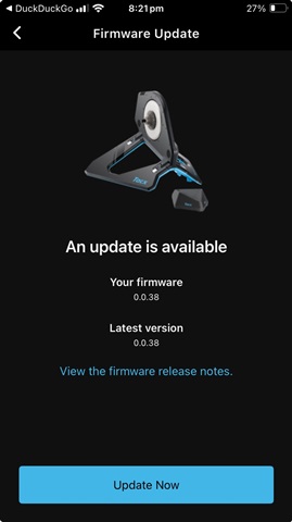

    5. The TTA then reopened and provided me with a link to downgrade my Neo 2T to 0.0.38.  (this downgrade link is only provided after you click the firmware restore link.)
    6.  I then followed the onscreen instructions to downgrade - (same as for upgrade.)

    3. With the Tacx App open in another window, clicked on the tacx api link.  Eg I had the app open, I then opened a browser on my iphone and clicked on the Link provided by Fulgaz.
    4 When you click on the tacx api link, it reopens the Tacx App and you then click on firmware.  You are then presented with the option to install 0.0.38.  (If you open the Tacx App and go straight to Firmware it will only show 2.6.0 and no option to downgrade.)

    1 ) I open the TACX App. 2) in that i go to see trainer... 3) open the link from there in another window, by clicking that link, it will open again the Trainer App from Tacx and you will come directly to this window here:
    But, there is nothing announced. "Aktualisieren" what means "update" at top right doesn't do anything and if you select now my trainer, you will see emptyness with no options to go for:
