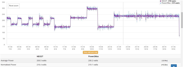

  • This is from today workout, I calibrate my power meter before start, after a while I have stopped and rise my saddle 2 mm
    So it almost match perfectly
    After stop, second and third interval , maybe because of the auto-calibration or saddle  raised, i had this discrepancy

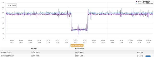

    Hello all,
    I've just bought a new Neo 2T and am having similar issues with low power readings. On threshhold range efforts it's more than 4% lower than my P2M NG (e.g. 252w average over 23 mins as opposed to 263w).
    I actually have two P2M NGs and two Powertap G3 hubs, all of which are pretty close even accounting for drive train losses, so the Neo 2T is the outlier.
    It doesn't seem acceptable that a device sold as being 1% accurate is reading 4 - 5% lower. I am currently using a very clean, relatively unworn drivetrain with squirt wax-based lube, so can't believe that drivetrain losses are accounting for 11w difference.
    Do I have a faulty unit or all they all faulty? If the latter, when will this be sorted with a firmware update? (surely quite simple to do if all 2Ts are reading low by a similar offset?).
    I really like the ride feel of the 2T and would like to be able to keep it. Although I can pair to the P2M for power in Zwift etc., I feel that having spent this much on a device that has a claim of 1% accuracy I should be getting something at least approximating that.. I'm also worried that if the rules for amateur Zwift racing ever change to only allow power from direct drive trainers in certain races I will be at a significant disadvantage (e.g. my girlfriend's Elite Drivo II actually reads 1 - 2% above my P2M, so about 6% different from my Neo 2T!).
