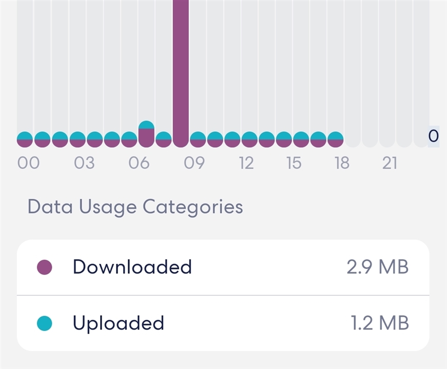

  • Even when you switch wifi off on the watch, it still stays connected. Below is a graph showing my VA6 has stayed connected to wifi all day, even though wifi has been switched off on the watch since 10am this morning. The only way to disconnect it is to turn the watch off.
    I've seen someone else has posted about the watch dying overnight, do this doesn't look like a standalone issue, but a bug. Please can this be looked at?
  • - please see my post above which shows how the VA6 stays connected to Wifi.  I have other Garmin watches, and this behaviour is not seen with any of the others.  The only way to disconnect it is to switch the watch off.
