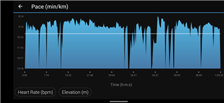

Here is an outdoor walk. it is one continuous walk, with GPS off (and a manual stride length set), and auto-pause turned off. I did not stop walking the whole time, and the pace/cadence was very consistent. As you can see from the graph below, the watch periodically thinks that I stop and then restart (which I did not), and it then struggles to recalculate pace afterwards. I believe that this is the same issue as I was having with the indoor. this did not happen prior to the last update, but whether it was the sensor update package or the 2.60 software update I could not say.
That looks normal. The holes in the graph are usually caused by temporarily not swinging the watch-arm. Maybe you are looking at the display of the watch, or taking something out of a pocket. Then the watch will think you have stopped for a moment.

I don't think it is normal. I've had the watch for a year and this has only just started happening.
