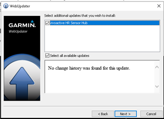

    Hello Martin. When i use Garmin Web Update and connect Vivoactive HR with PC. I see the additional wish to install: "Vivoactive HR sensor Hub" and below text display "No change history was found for this update"
    Then I still click next button to update. after that vivoactive HR display "installing update".
    Then I turn on Heart rate. But nothing change. In Heart rate widgets the number display "--" , heart symbol flash, no green light flash
