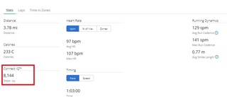

  • so I installed Steps to Fit and went for run, I can see the number of steps if I go to the history on my watch but on connect I can't see it, I am not sure what I am missing there
  • This is where you should see it if the field is added to the activity display on the watch..
