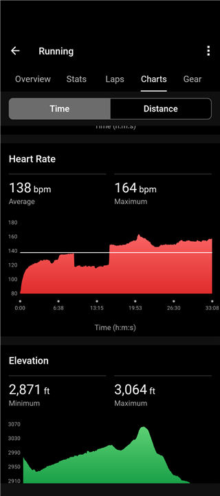

  • Exactly the same issue for me. It actually started on Venu 2 plus. I upgraded to Venu 3 and experience the issue on almost every run. The watch shows my heart rate too low during a run. I remove the watch and put it back on (while running). Heart rate is fixed immediately (jump 20-30 beats higher). I have many recordings of this bug.

  • Here is a typical view of the heart rate issue with Venu 3. It is complete wrong and when I take my watch off during the run it corrects again.
