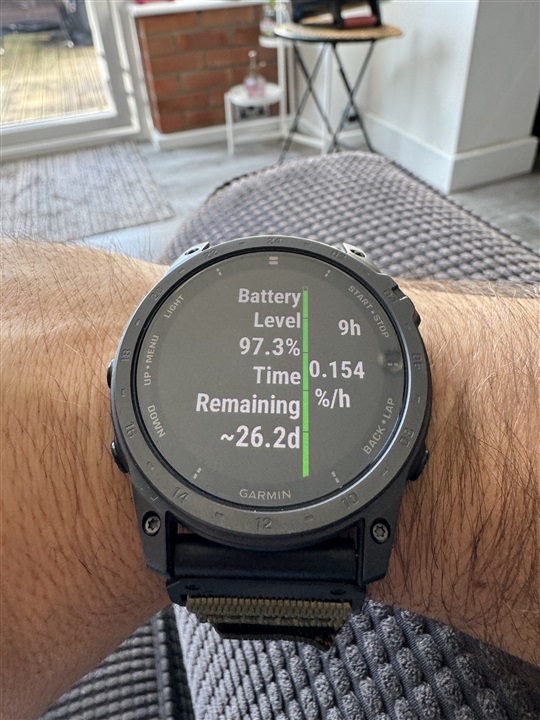

  • Just to summarise my statement.
    above is same app installed on my Tactix 7 amoled.
    It says it will last 26 days after I charged it yesterday Joy
    I have it several weeks now and with my current settings with AOD on etc it last me 8-9 days with two activities every two days.
    Yet this app says 26days.
    Pretty much useless then and statements above about 17 days of use on Venu are like fairytales.

  • I'm pretty sure the 26.2 days in your image would be if you use the watch in smart watch mode, e.g. no GPS activities. GPS burns vastly more battery than smart watch mode.
    If you did a 20 hour gps activity it would last even less than 8-9 days.
