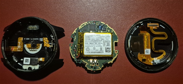

Hello all, my venu2 battery went dead and Garmin said it does not support its replacement any longer, so i decided to replace it myself.
While am in the replacement process, what is the recommended glue to stick and re-seal the screen back to the main body?
Thanks

  • Hello and thank you for the reply and suggestion.
    above is my own venu2 (not some from internet) and i understand the process and have the skills to achieve the task am carrying.
    My question was about the type/which glue is best suitable to glue back the screen body to the main body so it gets re-sealed
  • replying to my own questions and from some research seem B-7000 glue is what I'll be using

  • got the B-7000 glue but still waiting the battery delivery from china.
    Requires skills but is not a that difficult of a job and do suggest anyone to do it. It's 10 Euros/Dollars battery....how good only time will tell.
    Splitting the screen from main body is just a bit of heat all around with a heat gun and with a blade you can open a gap and using a plastic tool you can easily split apart. from there, 4 little crews and 2 flat cables.
    OEM battery has some sticky tape in the back and you need a bit of heat and plastic tool to split, all easy jobs
    when i get the replacement battery i was intended to post with the hope it can help someone. might not be the super fancy watch but still works for what it has been designed for and is a shame just because a battery the all thing is usually set appart....i currently own a Fenix8 but my son is in line for the VENU2 Slight smile
