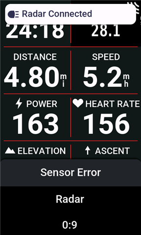

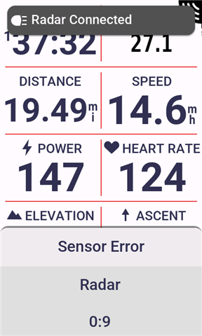

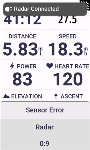

Seeing A LOT of these. Edge 1040 Solar 20.19 / Varia RTL515 3.34.

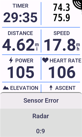

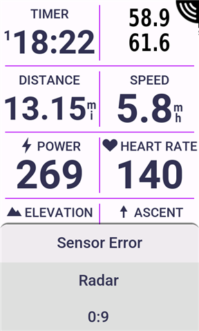

Right, but I don't need a modal warning that I manually have to clear ten times per two hour ride. Maybe just a special beep or something? Or just wait three seconds before showing the disconnectio…
The 0:9 errors are a product of the ever increasing use of driver aids on cars, which also have a radar component. The signals from these devices overwhelm & disrupt the signals that the Varia considers…
I keep emailing support screenshots of the error. They still refuse to adjust the firmware to remove the modal error off the main screen.
Garmin Support told me they won't fix it because it's an error. It's not an error if it happens every time you get a near a car with a car-detecting sensor. Neither Wahoo nor Hammerhead have this problem. Here's the solution, just beep and say "reconnecting". Usually the outage is less than a second. They still won't fix though. Multiple people on here have warrantied their Varia units because they think something is wrong with them.
Still happening with the latest Edge 1050 firmware..
I only get error when cycling under power lines, does not seem to be smart cars
I get them around cars. VERY OFTEN.

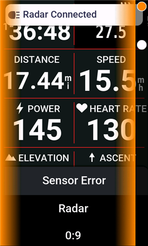

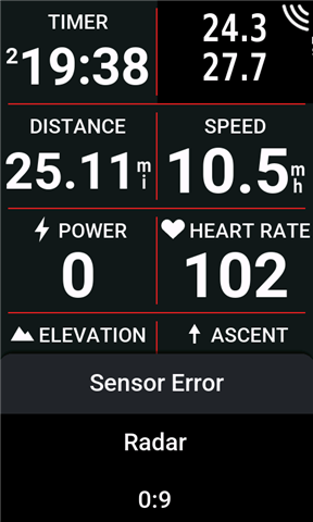

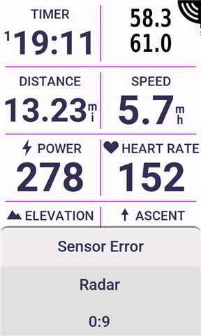

This is from yesterday from Edge 1050 on the latest 11.24 firmware. Four errors on a 90 minute ride!
Errors from yesterday's ride...
