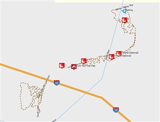

I had updated 18 maps to exist for Trailforks within this Hoosier National Forest (added Fall 2020).
I did mark them all as Mountain Bike trails.  A few existed in TF as hiking trails and I updated them to MTB trails (because they are in fact MTB allowed trails).
They all exist in Trailforks. (top picture)
Only a few of them were copied over to the Garmin Trailforks basemaps. (Lower left picture)
If I use a paid trailforks PRO account to copy their basemaps I can overlay it on the garmin (lower right picture).
This shows (yellow trails) that are missing from the built in Garmin basemaps.

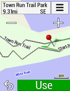

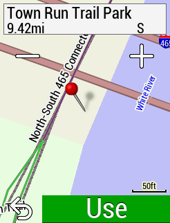

    Also - I found that PREVIOUSLY EXISTING trails from 2019.2 are now missing in 2020.10    There are literally (sections) of trails that disappeared.  They still exist within the Trailforks database (they were never removed).
    You can see what I'm talking about in Brown County State Park (Nashville, Indiana).
    First screenshot I circled the broken ends.  Second Screenshot zoomed in you can see OpenStreetMap filling in the blanks where Trailforks maps are missing sections.    (These were not broken before the update and are not broken within the main trailforks database).
    Trailforks has img map downloads for paid subscribers - I put one of those on my Garmin and the sections are not broken.  However the colors are all messed up on those so - still need Garmin to fix their maps.   :(
  • Former Member
    0 Former Member over 4 years ago in reply to Former Member
    On second glance, this is the Garmin device not rendering PARTS of trails.  For example, this trail is missing the top on the Garmin, but the trail itself is on the device.  It could be a firmware issue not rendering sections of trails.

    At this point, all trails in central Indiana are just missing random chunks.  This includes pre-existing trails that were fine in 2019 - 2020.
    The 2020.10 Trailforks maps are most definitely corrupt, at least for the state of Indiana.
    I have confirmed this with other users in Indiana, and the problem shows in Basecamp as well.

    Yep - they look fine in trailforks web.  They also look fine in the Trailforks direct (paid) garmin .img map downloads.  They never appeared to be missing chunks on anything other than the Garmin supplied trailforks map downloads.  I did open a ticket a month or so ago with Garmin but never heard back on it.
    The thing is everything looked fine on the Garmin supplied Trailforks 2020 maps.  Somewhere either during the data dump from Trailforks to Garmin, or the way Garmin compiled the maps with 2021.10, it just cut random stuff out.  Even some of the trails are still there but are just missing gaps here and there....really strange.   The screenshot above, the missing chunks are parts of trails that are still there with gaps. For example Aynes loops and Green Valley are still there, but with gaps (the gaps were never there in the actual Trailforks data from their side).  And the gaps weren't there on the Garmin 2020 Trailforks maps
