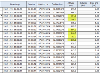

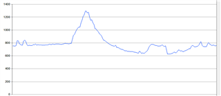

I can make some, if you'd like. GC course says almost 4000m, and in reality it's something like 800m. I drove it, so I know.
There are some weird spikes of about 120m on flat terrain, so that throws the whole course off.
It looks like bad elevation data in the file
