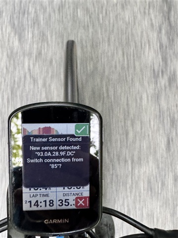

Hello - Just got a bike and my edge 830 keeps notifying me that the SRAM etap shifters are connected. Have had to turn off all notifications, but wondering has anyone had this issue previously, and found the solution. No problems with all other sensors, and have checked battery, etc.
  • I have the issue, I am getting dozens of notifications per minute. For the price we paid this is simply not acceptable. I have deal with your incompetence with numerous bugs in the past, that garmin is refusing to address,  but that one makes the device unusable.
    I cannot have 400€ paperweight, so if no solution is provided in the next week, I will be returning it and getting my money back, and finally move to Wahoo.
    I am literally typing this in my bib shorts unable to do my session ...

  • I am so frustrated with this problem! You can't do any of the suggestions because the alert just keeps popping up. I can't even power it down. At this point I will need to buy a Wahoo so I can race with data. Garmin this is unacceptable!
