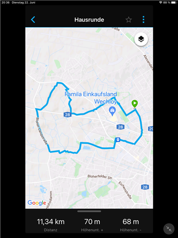

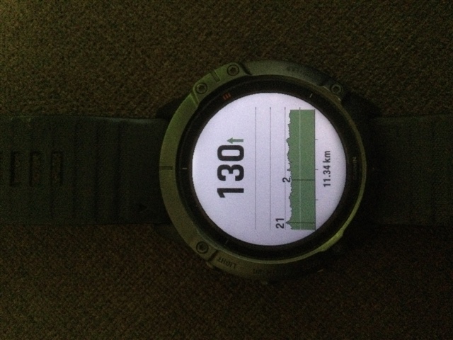

  • Btw: I planned a course in gcm:
    If I send it via gcm to my edge830, I get:
    if I send it via gcm to my F6xPS, I get

  • I wanted to show something else:
    I have done this course very often with different Garmin devices without using a course. The activity files are showing an elevation gain for this activity of about  only 14-16 meters (I live almost on sea level here). If I create exactly this course in gcm, I get an elevation gain of 70 meters for that course. If I transfer it to my Edge, I get an elevation gain of 162 meters, if I transfer it to may F6xPS, I get an elevation gain of 130 meters. So I think, the used elevation in gcm for creating a course must be faulty (for some areas) and why are the devices after course transfer via gcm showing different values?
