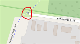

Why is the 530 not faithfully following the route - it seems to recalculate it's own path and avoid this section of my planned route.
First time it happened it confused me so much i nearly knocked into another cyclist - i've now gone back to the same spot 3 x and it consistently always not doesn't follow my route (photoshopped green arrow showing my route (magenta color)). Instead it reroutes to the main road......I have disabled recalculation - so it shouldn't recalculate and should just blindly follow my route ????

    It seems it won't go through a node that is designated as a "kissing gate" (a kind of barrier).
    When using tracks, I think the device should ignore barrier properties of nodes (that is, the routing algorithm should treat the node as passable and route through them. When using tracks, I think the routing algorithm should ignore the road direction. These things would be very easy to implement. (While you might not be able to ride through these restrictions, you might be able to walk through them).5

    In my case - A kissing gate exists to avoid cars/motorcycle (too big to fit through the kissing gates)  being used on the trail. So the 530's routed a go-around.
    Is there a "kissing gate" there? Street view shows bollards.
    While you wouldn't be able to drive a car through there, why do you think it's reasonable for the device to force you to avoid that location on a bicycle?
    Are you using a bicycle (or walking)? Are you happy with the detour the device wants you to make?

    "You were complaining about a detour around a spot it appears you wanted to go through. It's a 12 mile detour for something you could easily push a bicycle through." - it's a new area, so if the 530 decides to do the 12 mile detour, I wouldn't know better - until i realised this is taking much longer than expected. Again it's a new area to me - i would not recognise the turnoff unless the 530 points to it.
    Kissing gate or Bollard - whatever - evidently there's something there to block RidewithGPS to autoroute through it - I don't know if the 530 will perform like RidewithGPS with it's TBT. If it does it will make add a 12 mile detour to my route - not happy. Obviously i want to avoid that.
    Not "whatever". If you want to learn about the behavior of the device, you need to understand how these map features work and are used. Since the map features are supposed to reflect reality, then what is really there matters too.
    RWGPS shouldn't block routing for cyclists if it's a bollard on the map.
    Being specific about the feature is necessary to understand the behavior.
    The behavior (of RWGPS and the 530) has two places that could be the source:
    • If RWGPS does block bollards, then RWGPS's routing algorithm is wrong.
    • If the actual barrier is a bollard (not a kissing gate), then the map data is wrong.

    Anyway, there can be a big difference between the different type of barriers. e.g. this is the points file from the OpenTopoMap as an example.
    barrier=bollard | barrier=cycle_barrier
        { add mkgmap:bicycle=yes;
          add mkgmap:foot=yes;
          addaccess no;
          set mkgmap:road-speed=1; }
    barrier=bus_trap
        { add mkgmap:bus=yes;
          addaccess no;
    barrier=gate
          addaccess no;
          set mkgmap:road-speed=0; }
    barrier=kissing_gate | barrier=stile | barrier=block
        { add mkgmap:foot=yes;
          addaccess no;
    These files are used to convert the raw OSM data into a map file that the Garmin can use.
    Hopefully you can interpret from this that cycling would be allowed through a bollard, cycle_barrier, bus_trap (?) and gate but would not be allowed through a kissing_gate, stile or block.  Now although this isn't the same file that Garmin uses it gives you idea that the type of map feature is important.

  • Just to be clear, Davemorrisuk is showing the rules used to convert Openstreetmap (OSM) data to a Garmin "img" map (done using a program called "mkgmap").
    Hopefully, Garmin uses the same sort of rules in creating its maps.
    Barriers can also be tagged in OSM with "access" types. Ideally, those should be used when generating the map too.
    It's due to the existence of those sorts of rules that I updated the barrier in OSM to be a bollard (as it is in Street view). That update probably won't help Machoman but not will help others in the future.
    I think the path is dirt (it's doesn't appear to be in a densely-populated place (which would justify the cost and maintenance of pavement).

    Dammit - wish the Edge would just blindly follow my planned route - in RWGPS this 'gate' thing is preventing me from routing through the track properly.
  • Do you know what's really there?
    PM me the location.
