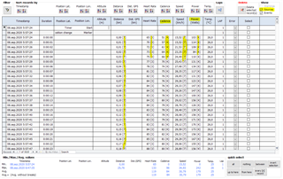

  • Former Member
    0 Former Member over 4 years ago in reply to Fab4mas
    thank you for sharing the fit file
    these are the sensors used
    the index numbers correspond with the logged data
    there is no bluetooth sensor connected
    index 6 is internal baro sensor
    looking at the actual data, cadance is coming from the assioma (index 4)
    • and this conflicts with the direto having a combined speed/cadance sensor
    • and the favero having a combined power/cadance sensor
    • if the direto had a single speed sensor instead of the combined one this would work ok
    • question stands , where do you set the wheel size Slight smile
    speed is coming from the direto
    index 7 is I guess the direto trainer
    happy & safe sporting

  • Former Member
    wait, uploaded your file here fit2tcx.runalyze.com  your fit file
    you see the settings  ! not all used but....
    assioma pm
    = TYPE=9 NAME=sensor NUMBER=147 --- unknown0=84627816=84627816 --- sensor_id="Assioma" --- message_index=1=selected=0,reserved=0,mask=1 --- wheel_size=2096=2096 mm --- unknown11=500=500
    direto speed sensor
    = TYPE=9 NAME=sensor NUMBER=147 --- unknown0=24711590=24711590 --- sensor_id="Direto speed" --- message_index=2=selected=0,reserved=0,mask=2 --- wheel_size=174=174 mm --- xxx73=1=1 --- unknown1=0=0 --- unknown3=1=1
    direto trainer
    = TYPE=9 NAME=sensor NUMBER=147 --- unknown0=84611494=84611494 --- sensor_id="Direto" --- message_index=3=selected=0,reserved=0,mask=3 --- wheel_size=2096=2096 mm --- unknown11=500=500 --- unknown32=0=0 --- unknown33=86=86 --- unknown34=500=500 --- xxx73=1=1 --- unknown1=0=0
    not used
    = TYPE=9 NAME=sensor NUMBER=147 --- unknown0=85004710=85004710 --- sensor_id="4518" --- message_index=4=selected=0,reserved=0,mask=4 --- wheel_size=2096=2096 mm --- unknown25=273=273 --- unknown26=100=100 --- unknown32=23=23
