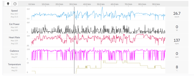

Since updating to 29.22, the touchscreen becomes unresponsive whenever the ambient temperature drops below about 11°C .

  1. Use Edge 1050 on firmware 29.22   when ambient temp is < 11°C.
  2. Try to operate the touchscreen (e.g., start a ride or open Navigation).
  3. Observe that touches don’t register or are extremely delayed.
  4. Warm the device (e.g., inside a jacket) and the touchscreen works again.
