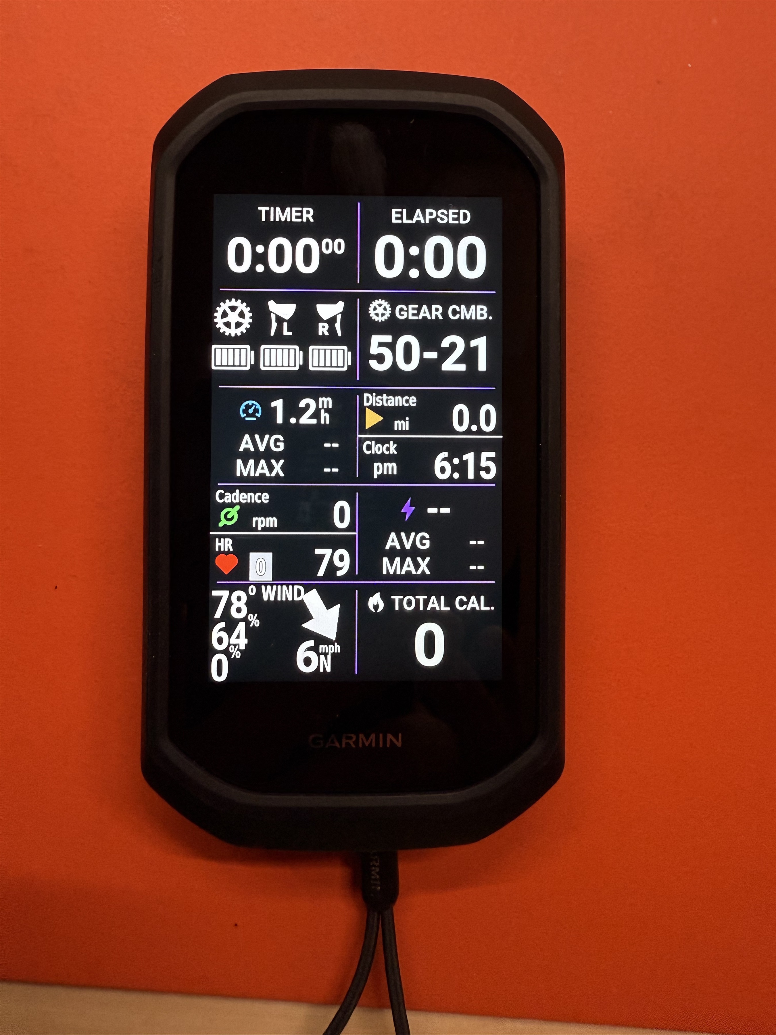

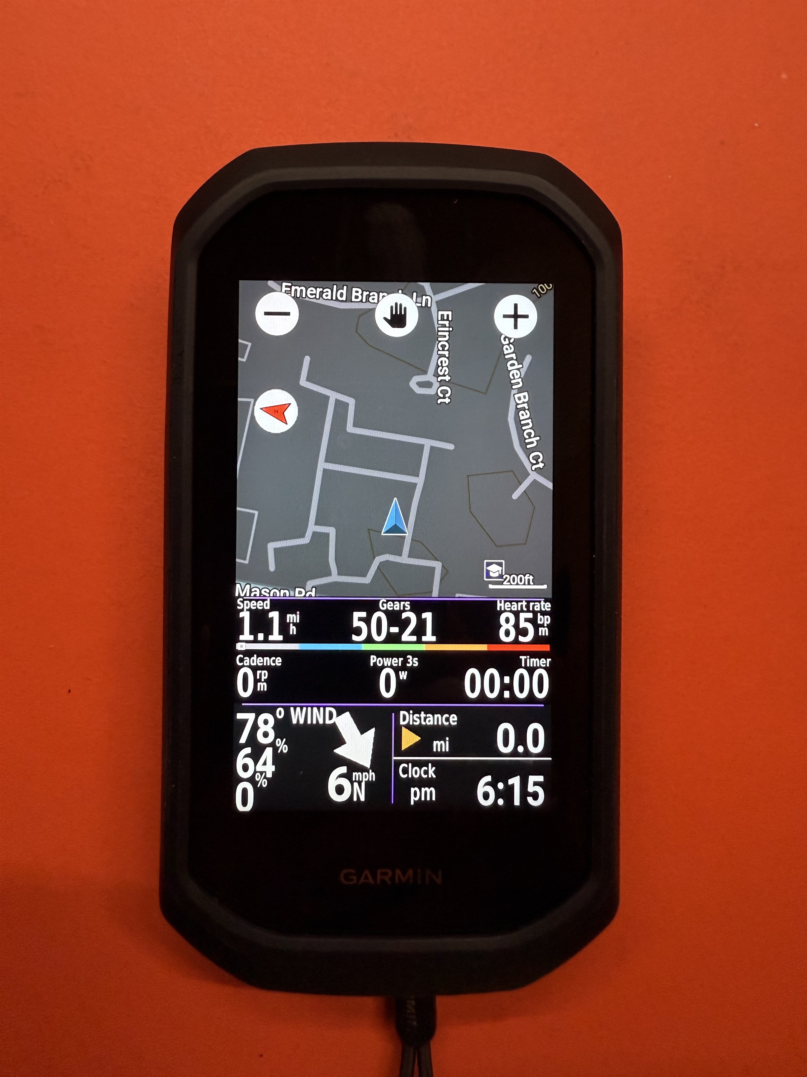

  • I also have an EDGE 1050 and 2 bikes with Ultegra Di2. Here are my 2 main pages so you can see how Di2 looks like:
  • Thank you for sharing!
